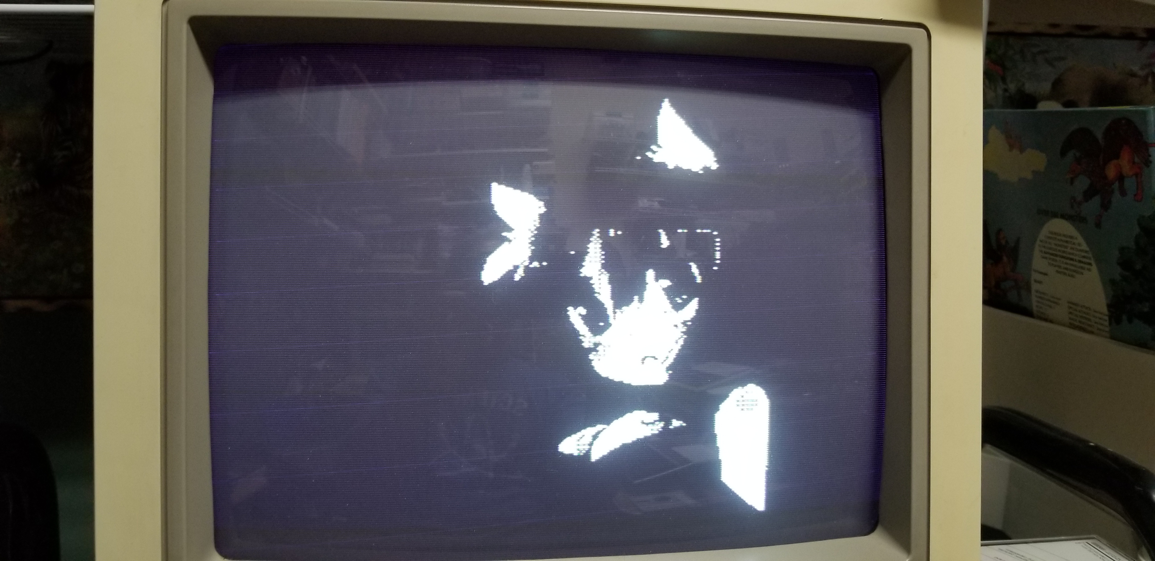

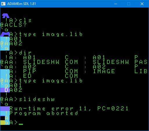

So I tried to do two more images but still not working.
I'll attach an image along with the screenshot.
I am hoping I am just doing something silly, but I have a bad feeling it may be the 64 bit thing making the problem? Not sure.
My DSK image is with the picture files incase you wanted to see what else I did. I of course haven't tested it on real hardware yet. Just got my SD drive today and the wife is occupying it with Jeopardy.

Wmaalouli
Posts: 155
Joined: Sat Jul 20, 2019 2:09 pm
Re: Slide Show program
Post by Wmaalouli » Sat Oct 10, 2020 7:15 am
OK I'll test it out tonight on real hardware and get back to you.
I never tried the program under emulation, so there might possibly be an issue there.

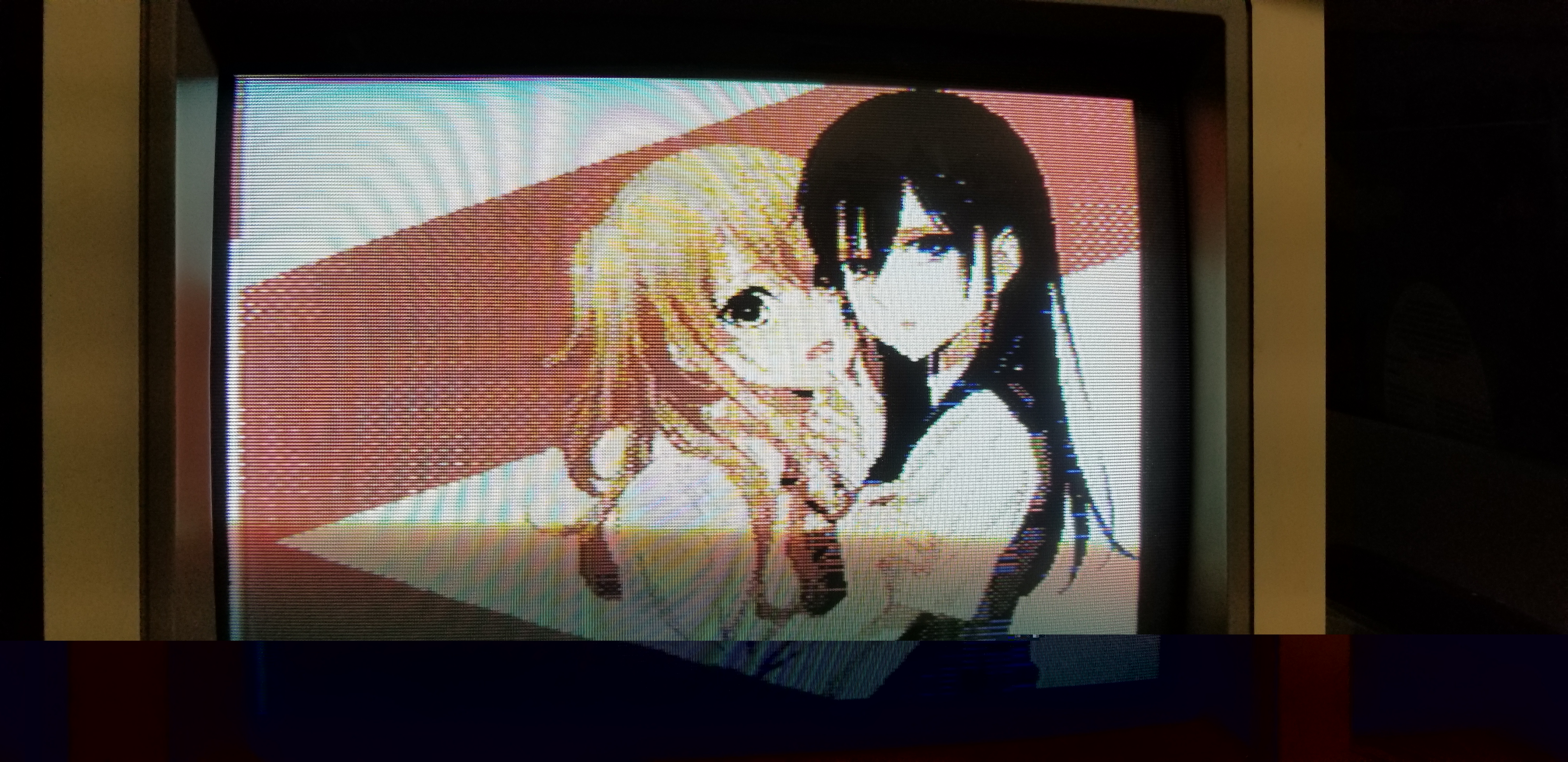

Post by Wmaalouli » Sat Oct 10, 2020 1:06 pm
So I putzed around with this and it looks like you did not use the Adamed text editor (viewtopic.php?f=6&t=7) to create the IMAGE.LIB file. The Slideshow program requires the proprietary file structure of Adamed for IMAGE.LIB in order to load the images properly.
When I did that, the images loaded but were a bit corrupted. Mind you this was all done under emulation and that might be causing issues. I won't have access to my real Adam until tonight.
Incidentally, image A01 is entirely black and white. Is this really the case? Otherwise the color file might be wrong.
Sixthview
Posts: 9
Joined: Tue Dec 03, 2019 8:01 pm
Post by Sixthview » Sat Oct 10, 2020 8:00 pm
You're right. I didn't use Adamed... Just ed. Still picking up on a lot of these nuances. I'll have to check that out.

Post by Wmaalouli » Mon Oct 12, 2020 9:06 am
I tested the images on a real system, and they work fine although there is still a little shift in the second image which might be related to a conversion issue. I use Adamed because it is so much easier to work with than the dreadful Ed :)
As of the Image manager, I think it's a bug in that program. When you transfer a .C or .P file, it will also create a second .COM file. Just delete the latter.
