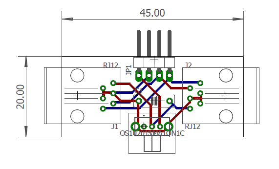

The main adapter will be for the NeoColeco adapter so available for all Colecovision users.  The force feedback is something I wanted to play with as a bonus for Adam users.  The code I am basing my adapter off of includes this ability, but I need to figure out a way to access it.  TBH this is an excuse for me to play with the AdamNet and figure out what it is capable of.  On a side note, I designed a breakout board for the AdamNet last night, my original design for this project, but I thought it might be nice for users who need 5v for units like the NeoColeco or ADE, assuming the current requirements are not too high.  It includes a switch to control to the power.  It is a simple little board and once tested I am hoping to share the gerber with the community.
							- Attachments
- AdamNet Breackout.PNG (22.56 KiB) Viewed 1304 times
