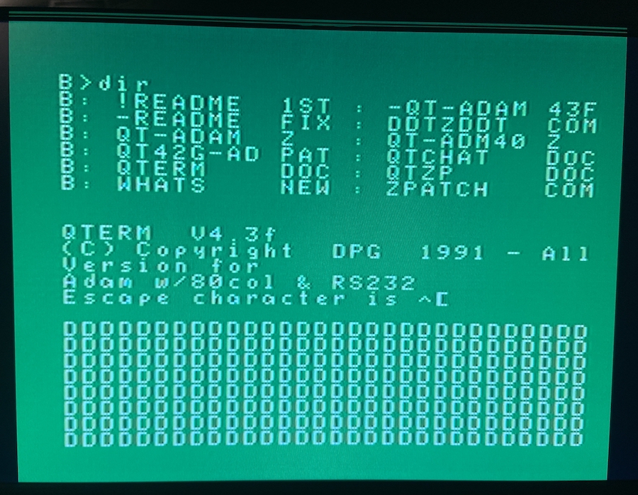

I do have an Orphanware/HLM-GMK side expansion box that adds a serial port. For some reason it has recently stopped working for me though. I'm not sure if its an issue with my expansion port or an issue with the device itself. When I go into ADAMLink V terminal mode now it just echoes a few characters like "DDDDDD" and then reports "Carrier Lost". I've tried cleaning the contacts but it didn't help.

Ok, I'll give quick term a try.
I am connecting it to a WiModem232. Everything was working flawlessly until last week. I did install my SD-DDP drive last week but I have also since tried removing it and I still have the same issue with the serial port.
Re: MIB238 Card
Same results with quick term. Just a bunch of repeated "D" characters...

First you have to set the baud rate (Esc B). And how is it hooked up? Null Modem? or ?
Re: MIB238 Card
Setting the baud rate made no difference. This happens no matter whether I have the serial cable connected to the WiModem or nothing at all. I don't have a null modem cable.
The even stranger thing is that I still get the stream of D characters even if I don't connect anything to the side port! This leads me to believe it might be an issue with my expansion port and not with the serial device. Maybe I knocked something loose when installing the SD-DDP? Not sure how that could've happened as the installation went smoothly and worked first try but I guess its a possibility.

That is possible - There was a post today on facebook of someones system dieing and they have the SD-DDP plugged in - you should post this on FB also - it definitely is not your serial card if its unplugged and the expansion port has nothing to do with the keyboard - the SD-DDP does since it goes through the master 6801 just like the keyboard does.joltguy wrote: ↑Thu Nov 05, 2020 11:06 amSetting the baud rate made no difference. This happens no matter whether I have the serial cable connected to the WiModem or nothing at all. I don't have a null modem cable.
