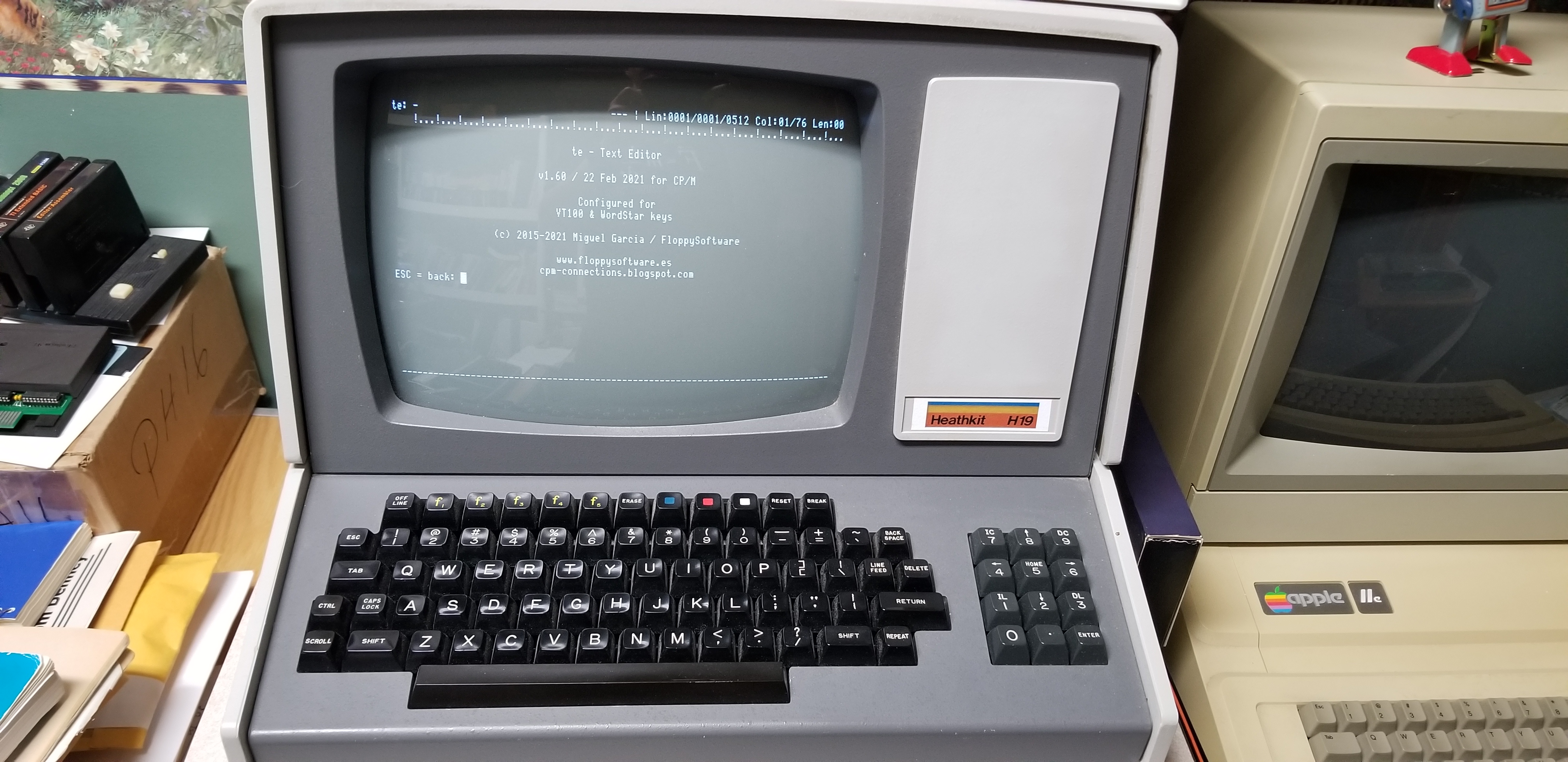

Post by Wmaalouli » Thu Jun 24, 2021 8:54 am
Incidentally that text editor works great with a serial terminal in 80 columns on the Adam.

Post by Wmaalouli » Sat Jun 26, 2021 7:27 am
Here you go. I have it on my Z80 assembler disk. This is the VT100 version however and will not display properly on the Adam 40 column screen so it won't be usable for you unless you connect an external serial terminal like I have done.
The TE author has created several versions for different target machines and I have not tested them on the Adam, so it might be something you might want to try. Here's the repository: https://github.com/MiguelVis/te
